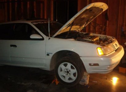

Heavily consider addressing this issue. Mine was making a similar ticking noise that I couldnt diagnose, I assumed it was the TOB and put it off to the side. Wrong! It got louder and louder, then I started getting worried. Then it spun a bearing! So I would say this is good idea to change them.
The bearings can be had for $40 and I believe the kit w/ oil pan seals and what not can be had for $60 from RCM Automotive.
It is way easier to do the rod bearings from underneath with the motor in the car. WAY easier.

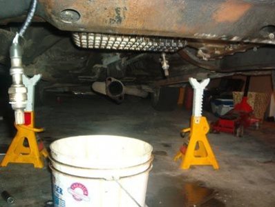

In a nutshell:
- Jack the car up
IM001079
- Remove the Y pipe, starter and drain the oil.

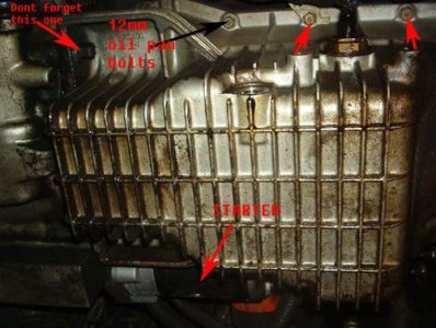

- Remove the oil pan
IM001084copy

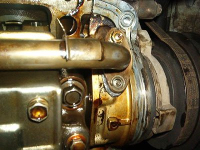

- Remove the oil pump pickup tube
IM001134
IM001133

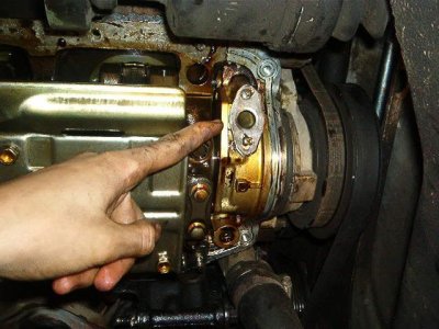

- Remove the "windage tray"
IM001092
-Remove the "crankshaft girdle"
IM001095

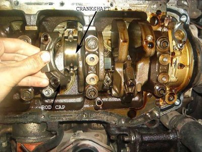

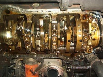

-Here is what you'll see. You can see the rod caps with the two nuts on each one. When you remove the two nuts the rod cap can be removed and you can replace the rod bearings one set at a time.
IM001096
IM001101copy

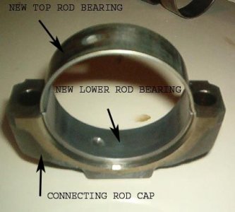

-Heres what the new bearing will look like installed (gives you an idea)
