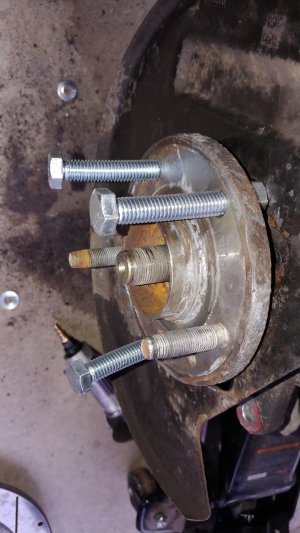

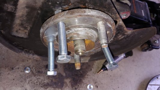

If your replacing a front or rear wheel bearing, cut off 2 lug studs and pound them out. Get two 1/2 inch bolts that are full thread (higher grade prefered) and use the bolt to press out the wheel bearing from two spots on the kuckle like below.
The nut will press the hub out as it is tightened. Use some lubricant on the threads.
Try to remove the wheel speed sensor. Un bolt it, the use a pocke screwdriver in the bolt hole as a lever to twist the sensor just a little while pulling up on it gently.
The axle nut is 32 mm, torqued to 258 lb-ft.
The hub bolts are torqued to 98 lb-ft
Caliper bolts 24 lb-ft
Caliper Anchor bolts76 lb-ft

lol, I had to do 3 bolts, and after breaking off 3-4 half inch bolts, I resorted to using an impact on the bolts and it finally came off.050518200210505182002

Glad to see it worked for you. I hope you feel it was *esier* than trying to chisel it out, or pound it out from the back side.

Yeah, the wheel bearings are a pain in the ***, especially if you live in one of the northern states that uses salt on their roads. I ended up taking my car to my mechanic and they had to use a hub buster and 30 minutes of heat using an Oxy torch.
