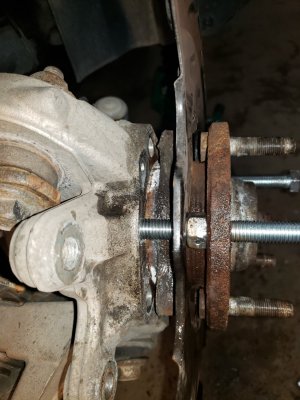

If your replacing a front or rear wheel bearing, cut off 2 lug studs and pound them out. Get two 1/2 inch bolts that are full thread (higher grade prefered) and use the bolt to press out the wheel bearing from two spots on the kuckle like below.
The nut will press the hub out as it is tightened. Use some lubricant on the threads.
Try to remove the wheel speed sensor. Un bolt it, the use a pocke screwdriver in the bolt hole as a lever to twist the sensor just a little while pulling up on it gently.
The axle nut is 32 mm, torqued to 258 lb-ft.
The hub bolts are torqued to 98 lb-ft
Caliper bolts 24 lb-ft
Caliper Anchor bolts76 lb-ft

lol, I had to do 3 bolts, and after breaking off 3-4 half inch bolts, I resorted to using an impact on the bolts and it finally came off.050518200210505182002

Glad to see it worked for you. I hope you feel it was *esier* than trying to chisel it out, or pound it out from the back side.

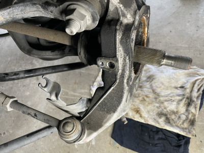

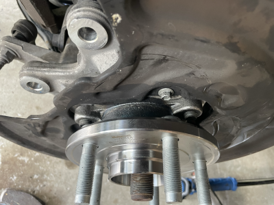

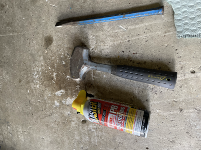

Just replaced both rear wheel bearings and man were they shot, driver side more-so than the passenger, at any rate, I was all prepared to utilize Shadow351's method but since the car has been in the dirty south its whole life there was not much corrosion going on. I did find out if you take off the speed sensor and spray about a gallon of penetrant into the hole and onto the bearing, rotate it a bit, take all the other bolts and parts off, to give it time to work, whack it on one of the legs/arms with a three-pound sledge and a decent sized chisel that sucker will come right off.
First pic is where the penetrant goes, second is the part I ordered from Rock Auto, third show the leg/arm that you whack with the chisel and sledge. I like PB Blaster but you do you.
