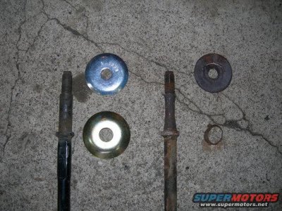

You know, it's funny that this thread is here... I just replaced these very items on my SHO today. Although you can look on the bright side... your tension arm didn't pull through the corroded washer during hard braking and almost **** you. :nut:
Dscn1530
I strongly suggest that you take Fred up on his offer of rear tension arms. I got mine from Kurt of SHO Parts Northwest, since all the parts from the left coast tend to be devoid of rust.

If the hole through the control box is intact, the bushings squeeze the hole, the washers squeeze the bushings & everything's pretty tight back there. If the hole through the control box is rotted out, you'll want to weld reinforcements. I believe you can also look into using the Moog problem solver kit for the front strut tension rods to beef things up a bit, but again, only if the control box is still rigid. I think going that route's a bit overkill though.
Your tension rods show signs of corroding where the bushings normally live, that's why I offered the rods - the metal's typically a much smaller diameter than normal. See Hamal's picture for reference.
