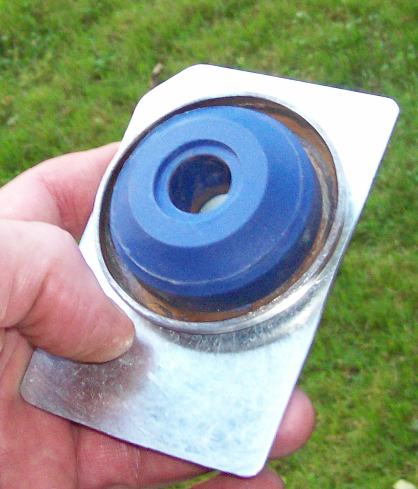

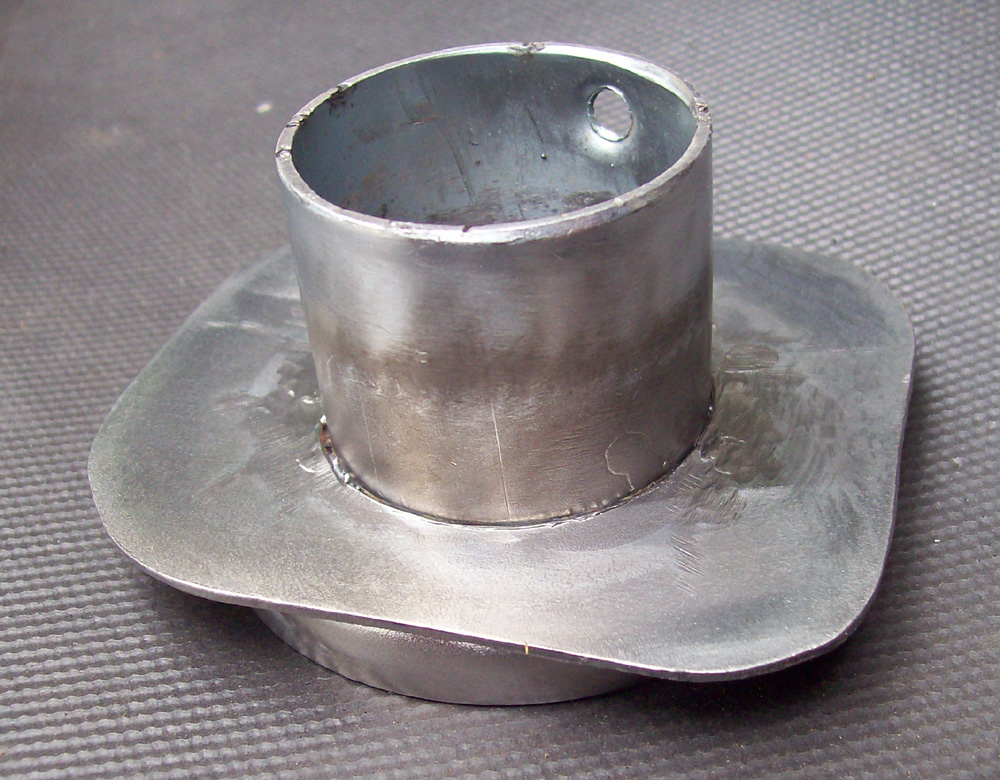

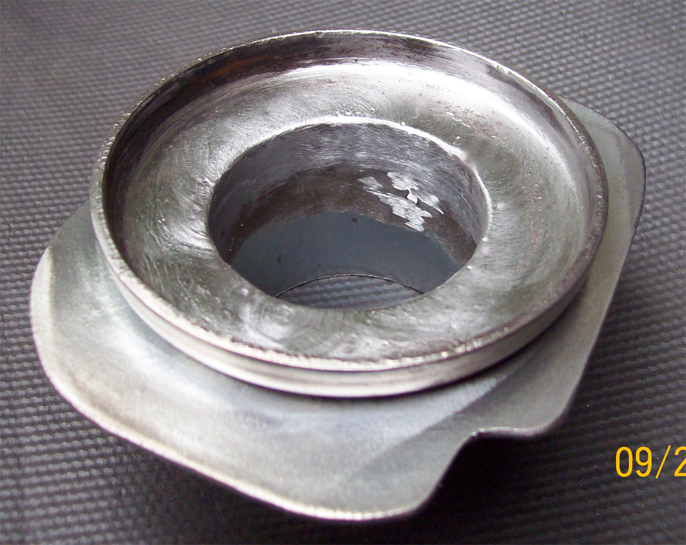

- Okay. Since fabrication looks like my only practical option, I'm proposing a solution, offered here for critique.
Pic 1. Pic 2.
Two rectangular plates fabricated from 14 ga. steel - the thickness of the original washers. The plates will sandwich the back side of the existing bracket/box. After rust proofing the box surface, automobile panel adhesive will be used to strengthen the assembly and prevent water intrusion. Then the plates will be through-bolted together.
The exterior rings will be cut from 2.5" i.d. tubing, and the center locating "stub" will be from 1.5" i.d. tubing. Five pieces in all combined into two parts, from readily available materials and a little welding/grinding outside the vehicle prior to attachment.
Comments?
- Jay

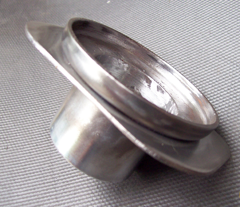

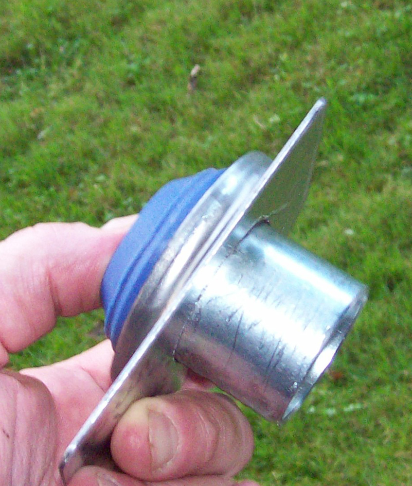

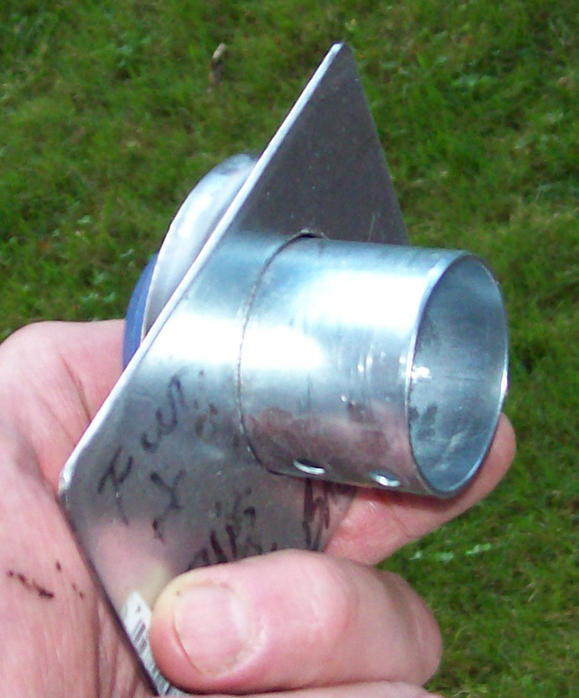

- Extra update because of the interest in this thread. Pics below show a mock-up of the front plate. No welding done yet. The cupped washer is original to the car and perfectly servicable, so I worked it into the plan. The through-tube will be cut to length as soon as "length" is established.
No work yet on the rear plate, but the rear washer is gone, so I'll follow the plan for that.
Pic 1 Pic 2 Pic 3
Props to Sho Parts Northwest. The used TSR's they sent me cleaned up perfectly. No rust, and dead straight, as promised. At a cost of $39.50 total for the two of them - including shipping, I couldn't be happier. Thanks guys.
- Jay

That steel does not look very thick.
- Agreed. I wasn't going for "very thick", just "thick enough" to do the job correctly. With this assembly there will be more steel in thickness (+.080") and area on the forward side than there was from the factory. Steel on the rear side will be equal to the factory in thickness, and greater in area.
Remember that adding thickness to the rear of the mounting point will push the hub towards the rear of the car by the same amount. I would have to shave the bushings to compensate.
The planned assembly will exceed factory strength considerably when the two pieces sandwich the mounting point, and will not change the original location of the hub.
- Jay

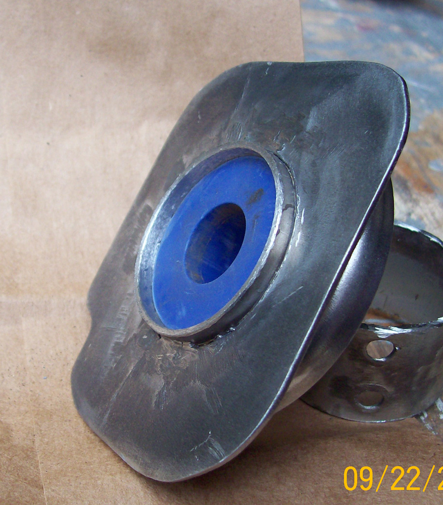

- Finally got some time today to finish fabrication of the front piece. I'm declaring it short on purdy and long on sturdy. Not much to show for the rear piece. Just the flat plate with a hole in the middle to recieve the tube.
Pic 1, Pic 2, Pic 3, Pic 4.
Two coats of rust preventative on these and the replacement TSR's. Final assembly of the rear suspension tomorrow. I've discovered that the bias valves are frozen. After reading a lot of posts, I'm going to remove the valves and weld them to make plugs. Can't find specifics on this process anywhere so I hope it's apparent when I pull them out.
More to come.
- Jay

- Update. Yes, and no. Yes, it is installed and works just great. No, I can't find the pics I took. I definitely have pics, just need to dig them out.
Nothing more to see though. Pic 4 above shows the front half cut to size and explains the rear. I prepped all surfaces and double-coated them with Rust Bullet. I also used butyl rubber caulking between the "sandwiching" parts I fabbed and the mounting surface they sandwich between them.
I wanted to completely eliminate any water infiltrating the assembly. The caulk achieved 100% coverage as evidenced by squeeze-out. Sprayed on rubberized undercoating to make everything black. Let it set up. Assembled the rear TSR and bushings. All is now well with that part of my personal SHO world.
Need more? Ask away.
Thanks for your interest.
- Jay

Good questions, Hamal.
1) Were you able to get dimensions of the finished pieces?
I did not take any measurements of the final pieces. I started with a 4" x 4" piece of steel for each of the two "sandwich" pieces. That was more than enough material.
I used a piece of standard printer paper to begin the template. Just forced it into place and traced the edges with a fingernail. Trimmed it a bit to fit and transferred that to some file-folder material. Then to some light cardboard for the final template.
The final shape will be odd after you cut reliefs for the drain holes and shroud.
2) On the locating rings.. did you weld yours to the 1 1/2" metal conduit, or was it a press fit, or what?
The conduit was not a press fit with the ring. I started with the front-side "sandwich" piece, placing it into position and tracing the hole for the TSR. I cut the hole carefully to allow just enough clearance to pass the conduit.
I then welded the conduit to the back of this "sandwich" piece, leaving the end of the conduit protruding through the front by the thickness of the locating ring. I then centered the front-side ring on the protruding conduit and welded them together. The welds don't show in the pic because I ground them down.
Hope this helps. If not, ask more.
This fix is still solid.
- Jay
