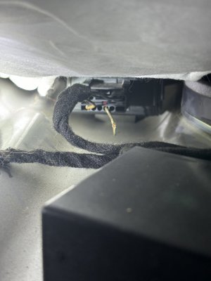

I seem to be in the small boat here of loving the sun shade up. I found another comment in the form that was linked above that solved the issue without disconnecting the whole wiring harness. My sun shade motor just started to make the clicking last night probably due to the gear finally snapping after 14 years. It is a 2010 Taurus sho and there is one wire to cut. The bottom 4th from the left 3rd from the right. This is the wire that puts down the shade every time you put the vehicle in reverse. Cutting this lets me keep the shade up indefinitely. I wish I had known this years ago because I always want the shade up. The color may very depending on the year but the location on mine was the same as the 2013 I found in the other post, just different colors. I checked mine with a meter before cutting, that is why you see a partially stripped wire that is also cut in my picture. Hope this helps someone avoid tearing deep into it to get to the motor. It might have to happen some day anyways, but today is not that day!
I hope it helps someone who is searching for how to do it. One wire clipped and you'll never look back. The wire may be a different color depending on your year, but should be the same position on the wiring harness.The reason this forums is awesome- great share
