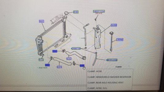

Well shoot. Mine's got a worm screw on the bottom. Do you have part numbers for these by chance? And these are def for a 94?
