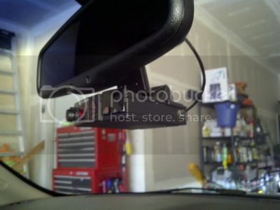

Mount it to the left of the rear view mirror. Mine is in a perfect spot. If you put the visor down, the sensor still shows to the right of it so it still picks up rear signals. Tuck the wire in the headliner, down the a pillar, to the fuse box. Piece of cake.

I used Blendmount's V1 mounting to the mirror and then ran their 3" power adaptor to the voltage point on the back of the mirror. The way I have it wired is that it's powered on in every state except when going in reverse to remove any distraction when viewing the reverse camera.
www.blendmount.com
