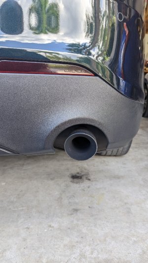

I’m about to buy those mrt muffler axel backs instead of corsa now due to this 2500 dollar repair lol
I am glad for you those MRT was a month of me tooling around forums and YouTube I really like the sound they make. Not raspy and that rap rap rap. My only issue.... Not black tip option.
Those tips will be black after about 200 miles. Lol!
ROFL - with Catless... You are 100% correct - my bad.
