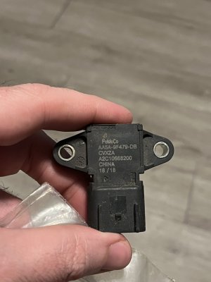

@Zpak im kinda in the same boat as you as far as the t-stat goes and just assumed for tunes colder plugs (gapped .028-.029) and an upgraded MAP is what was needed. I just keep reading again and again people doing a 170 degree. I thought a 180 degree was stock, I didn’t think 10 degrees would make that big of a difference, but then again I’m new to this generation SHO. **** my twin turbo C5Z made 600ish whp and it was running the stock 190 degree thermostat.
When I bought the intake I believe a 2.5 MAP came with it. I assume a 2.5 bar will be fine? I’m under the impression the 2.5 bar will read up to 22 PSI. Which is more than the efficiency of the stock turbos?
Pic of said MAP that I received.

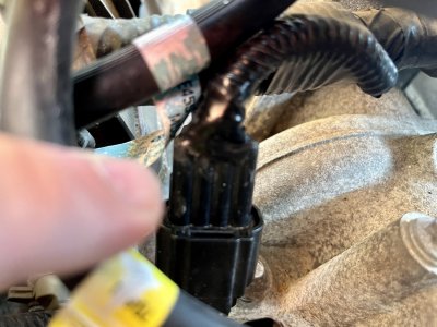

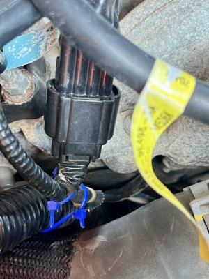

Well a little update for anyone who cares:
Spark plugs checked/gapped and installed.
I don’t know which I hate doing more the rear plugs on this car or the rear plugs on the several GTP’s I have owned in the past. Regardless, after many choice words and an hour later it was a success. It’s not so much the plugs, it’s the freaking coil plug wires. There’s so much vacuum/suction on them it reminded me of my first BJ.
Anyways installed the 2.5 bar MAP and
GH tune. Drove around to get it up to operating temp and then did a pull. I was like that’s it? It feels stock or even worse than stock. So I did another pull and I could hear the car just dumping boost. Hmm that’s not right. Pulled over, popped the hood, and noticed I forgot to plug the front wastegate sensor back in after doing the plugs.
Did another pull and we are back in business But wait what’s that? Datalog is showing 3.5* of knock at WOT. Hmmm.
Contacted GH and they asked about the plugs and what they were gapped at. Gapped at exactly what you guys told me to gap them at when I called prior to ordering the tune. So we are good.
Next thing, I was told to check the wires at the knock sensor for chaffing. No problem, checked and it’s apparent someone either fixed this already or Ford resolved the issue on the 2017’s cause no chaffing.
Regardless, they have been shrink wrapped, put electrical tape around both ends and I have zip tied them away from the block. So off to make another WOT run and datalog. Hope that fixed the issue.
