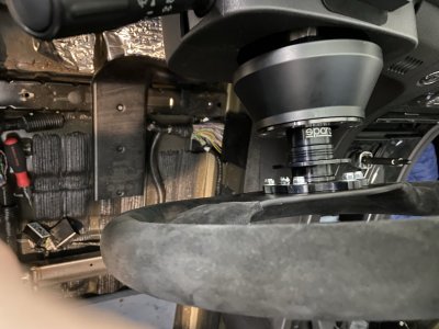

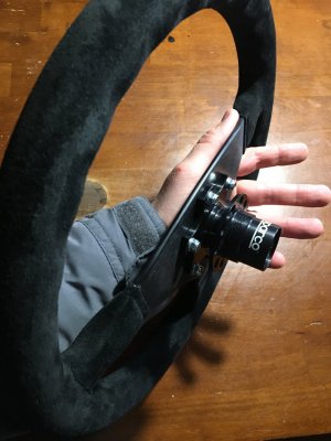

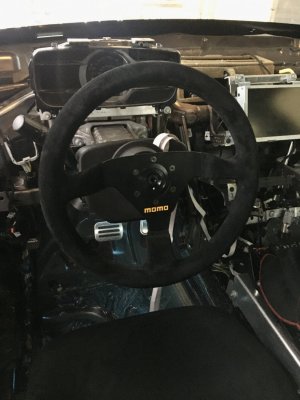

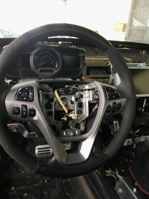

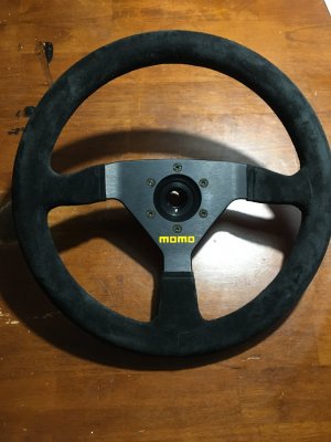

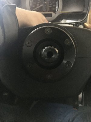

This has been a joint endeavor between @802SHO and myself as we weren’t sure this would work and thought we would need to make a custom adapter, however after trying some off the shelf options we found that the mustang/focus steering wheel adapter is directly compatible with the SHO. I used the following momo part numbers and sparco quick release assembly. The turn signals still work, however I lost cruise control, the air bag, and the steering wheel buttons. As this is my weekend toy and now dedicated track car I’m not to worried about it as I have a racing harness and racing seat and pumped that aftermarket options are available that require no modifications to install. The steering wheel, adapter and quick release come in at approx $600. I’m hoping @802SHO will post his install pictures and weigh in on the project as his setup is very cool as well.
Sparco 015r98tu
Momo 4538
Momo r1913/35s

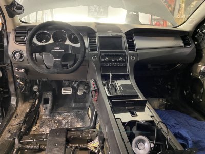

802SHO
Boost > VE, MBT, Cams
Oct 8, 2019
3,235

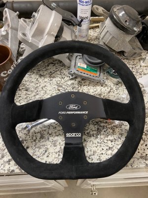

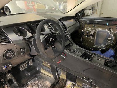

7,801
Essex Junction Vermont
