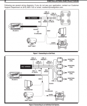

Alright guys i need help either finding an rpm signal...which is not likely or finding where the COPs main power wire so i can tap it for my RPM switch for the nitrous, anybody know where i can find either. Ive been looking through the web but have only come across a couple wiring diagrams that only pertain to audio stuff
RPM would probably have to come from CKP or CAM sensors. They return directly to the PCM and then probably go to the CAN. CKP appears to be a yellow/violet wire. CAM is brown/blue or green/violet depending which one you are using. As far as the COP (coil on plug I assume), main power is a violet wire coming from Fuse 68. Not sure how the power wire will help you. It seems like it would be a constant 12v. I would think you would be more interested in the command to fire signal which comes from the PCM. This is pin 2 on each coil. (1- white/violet, 2- yellow/blue, 3- blue/orange, 4- green/violet, 5- white/brown, or 6- violet/brown)
