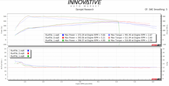

Me and some of my buddies had a DYNO day, One of my old street racing buddies owns the dyno so he hooks it up on price if i organize a small group to go. Heres the new numbers

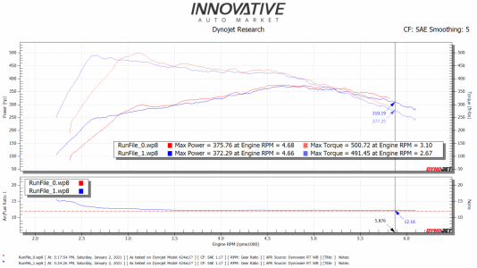

he also attached the last dyno i did with him. On the 375hp dyno the Auto Octane tune from Gearhead was at .42 instead of the .96 it was reading this last time, the only other difference is the 70mm throttle body an it picked up 21Hp. I the middle number was with the car spraying methanol as soon as it starts making boost... its weird to me that the car made less power spraying methanol and after researching other peoples experiences could have been caused by spraying it too soon... Has anybody had any problems with this? Another thing does everybody dyno their SHO's in 4th gear... cause the 1:1 gear is 5th but a 5th gear pull would be ridiculously long... and if everybody is dynoing in 4th that would actually mean that you would make more HP in 5th... the 4th gear ration on a non pp is 1.41:1 which is a .04% power difference if the information ive found is correct.Dyno s

Is it tuned for meth and is it 100% methanol? My methanol tunes have always been moderately dependent on meth. I’ve never used meth for ONLY cooling. I’ve always used it for more power through increased octane, increased fuel, knock suppression and cooling the IAT2 temp. Without it I’d have a problem.
If youre not tuned for it you’ll definitely run rich.

THIS IS THE THING ITS NOT RICH AT AT ALL IF YOU LOOK AT THIS DYNO SHEET THE AFRS ARE LOWER BUT BY NO MEANS RICH, IM USING THE #6 NOZZLE WHICH IS 625ML/MIN AND I WAS SPRAYING AT 2PSI RAMPED TO 5PSI SO IT SHOULDVE BEEN REALLY RICH. THE RED LINE IS THE METH RUN ON THE DYNO. 802 Who are you using to tune? I was using 50/50 but will gladly spray 100% methanol if it will net results. DYNO AFRS

Hey just fyi in case you're not aware, these cars have widebands from the factory. They also run continuous closed loop, so don't expect to very easily tweak your AFR with jetting. *edit: this goes for meth as well. Hose in all you want, the ecu is just going to cut back the injectors. Problem with that is a lambda target that's safe and optimal for gasoline is a preignition timebomb for methanol.
With wet nitrous or large amounts of meth It would probably be a good idea to have a race only tune that disables closed loop or specifically lowers lambda targets for whatever you're spraying. "Too rich" is not a thing when it comes to methanol on its own. Meth & gasoline combined is more complicated though.

i noticed this when i was attempting to spray methanol at my last dyno session... the car was not tuned for it and i was thinking me spraying meth would richen up the mixture a bit....it made less power and the afr's were the same it wasnt a big decrease but definitely made me come to this conclusion that the ecu is gonna correct and offset the fuel being put into the mix. stripSHO thanks for the advice ive been looking for this type info. I wasn't planning on running the meth with the nitrous, i was actually thinking of taking the whole meth kit off to be honest. Gearhead has expressed that he doesn't tune for meth, so that being said i wasted money on that lol

meth is a great sub for the cooling part and most will not tune for dependent. the biggest mistake is most spray too much and over fuel the motor thus making less power. the whole point is to bottom out the short term fuel trim without adding the over fueling. if your STFT is close to .71 (this is the bottom) at WAT your in the right space.

You can still run meth without being tuned for it. Tonight my car did 464whp no meth. 503 with meth same tune no adjustments. Methanol still has a ton of benefits like dropping the Intake temps and allowing you to build boost faster and maintain power through a pull even without being tuned for it.
