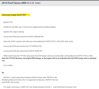

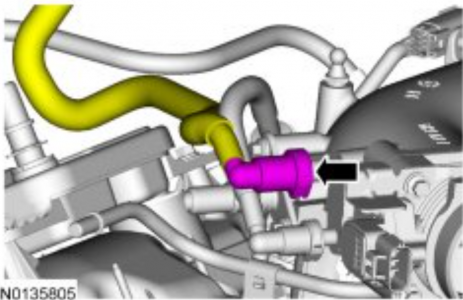

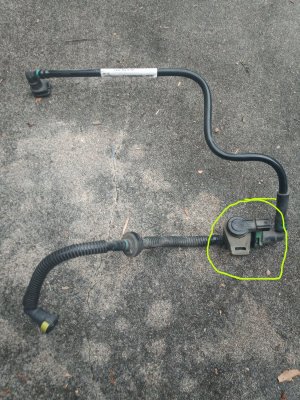

Along the back of the intake manifold. The lower end connection connects to throttle body. The upper end connection connects near the firewall. To check the purge valve disconnect the end near the firewall and the electrical connector, start the engine and see if there is vacuum present. There should not be any vacuum. Did you check for codes?

I believe this is the right position on the TB
