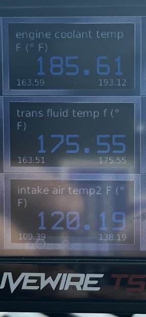

Oh forsure changing every single fluid after purchase... I'm most likely having to purchase out of state since SHOs are not common around me... I intend on having everything changed prior to driving it back home... But that coolant swap info is very interesting... I will look into doing that
22 mile non highway trip on a warm start. Ambient temp 83° (real feel 92°… if real feel applies to cars too? Lol)
B6757009 F977 42A3 A231 2E06FD8F148C
