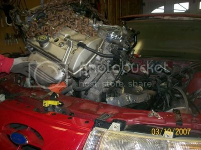

Thanks Jason for the pics! I am going to attack the motor mounts on the subframe and the trans mount.... Once those are loose, can the block be pulled up with the bellhousing and tranny still attached? Also, is it just sensors and exhaust I have to dissconecct, and basically its ready to pull?
