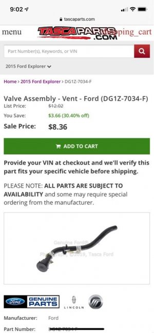

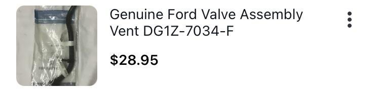

ebay doesn’t have it any more. PN# is good.
The original metal top hat vent with rubber duck bill valve gets glued shut and clogged causing positive pressure in the PTU when it gets hot and then it belches oil out the side main seals. This mod prevents that and has a felt disk vent at a distance away from all the sloshing. :)
Plus, can use a funnel and the line as a fill line after you drain the PTU on a regular basis.
