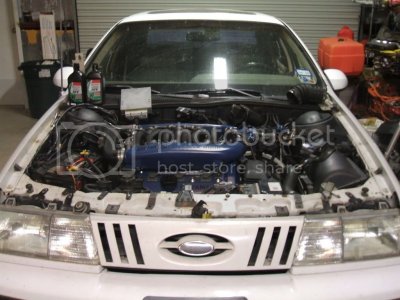

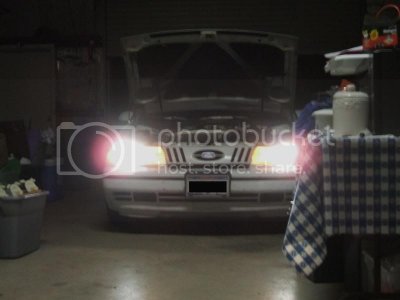

IIRC, in the last pictures I saw of your car, your headlight lenses were not very clear and didn't look to be aimed right. Maybe you should get some new housings and aim them correctly. It makes a big difference.
:shrug:
DSCF0753
DSCF0586
DSCF0675
DSCF0674
They are less than 3yrs old. I also have them on a HD harness that I built. The fogs have a HD harness as well.
I may pick up a set of 80/100w bulbs and see if they do they job I need my lights to do.
If you look at that picture against the wall there is a TON of light above the cut off which GLARES like **** in oncoming traffic... plus you are loosing that light and defeating the purpose of a projector.
Granted there is some light above the "cut-off". My point in this matter is that it is no where near what the glare would be with HID's in stock housings without projectors.. Actually, the projectors in stock housings probably have ALOT less glare than the stock housings do without HID's.
EDIT: also, it seems as if the camry's lights need to be aimed properly. In the last picture, they look way too high.
