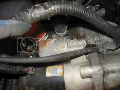

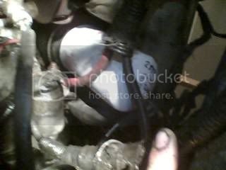

Ill take a pix really quick
Ok, the one in the middle where it splits red and black (comes from battery), you can see where the positive end goes, and the neg goes to the subframe.. The other one that im pushing out of the way comes from the drivers side of the car and has 2 positives, one for starter and the other for alternator.... correct me please if im wrong

The large negative cable should connect to one of the starter mounting bolts that goes through the bellhousing, not to the subframe.
