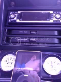

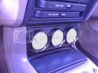

Side note:
Here is how my SHO supports my Ipod..
1115070007
1031070002
Ash tray flips up to reveal an Idock plugged into a FM transmiter that uses the antenna wire..
enough of me showing off...
