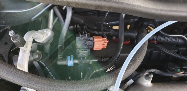

I've ran E30, E50, or E74 (pump E85 here) almost exclusively for the past 2 years, and up until COVID I consistently put 100+ miles a day on the car Monday-Friday every week. I can't remember the last time I ran straight 91 except to just verify the nGauge tune when we switched to HPTuners. Only cold start issues were with E85, which is to be expected.
All answers above are great advice. Get an ethanol sensor and let er rip.

I believe your questions are answered but just wanted to add, maybe reassure. I started using e30 this summer. I installed a Fuel-It Bluetooth ethanol reader and sensor. It’s unnecessarily expensive but worth it to me piece for of mind. I was worried about mixing at first but after a couple times it’s no big deal. I use the E85 calculator app and test actual E content at the stations I frequent usually every third time. It’s always been between 70-72% for me. I average 300 miles of driving a week, the car rips, and I’m still in the high 19’s for MPG’s. So yeah, I have no beef running e30 on a daily.
Where did you get yours from I see them all over the place but there's different styles do you have a link to where you purchase yours.

It just taps into the fuel line at the passenger strut tower then the new hose connects to the HPFP.
