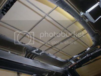

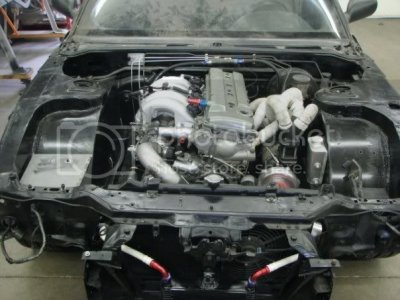

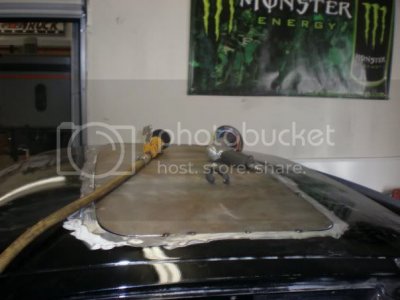

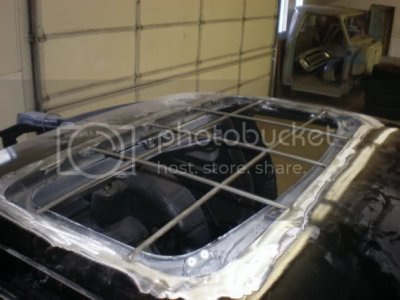

This is what we did on project 240, I don’t have any pictures since its been completely welded but it came out perfect.
240
240a
240d
240c
240e

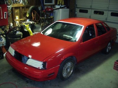

We went to the junkyard and cut a panel out of a non-SHO '91 Taurus to fill in ours... even found one the same color!
krek
ChumpCar Racer
Aug 15, 2009
89
154
SHO Me State
4444812266 a4e331f7f3
I'm not sure how well it shows up under a roller coat of Rust-o-leum... but hopefully you get the idea.
