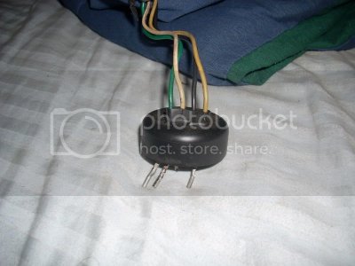

anyone have pictures of the wires coming out of the steering actuator on a 93-95 sho with the vaps system. somehow or another the wires on mine ripped out. so i need pics to re-solder the 4 wires back onto the clips. my ford repair manual doesnt give me a good color coded setup. so unless i go to a junkyard tomorrow and crawl under one, then im kinda sol.

I took the pic a while ago and posted it in this thread. Be sure to read it and note the last post though. The picture I took shows it "backwards". It should be:
[Passenger side] Yellow, Black, "White" (doesn't look very white in the pic), Green [Driver side]

thanks. i think i basically just replaced my pump due to what i now know is open actuator condition. on highway it would be a huge difference between power on and power off steering. like in mid turn if i let off gas it would be like... omg wtf happened. o well. try to fix this today and get the car buttoned up this week and hope all is fixed.
