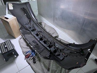

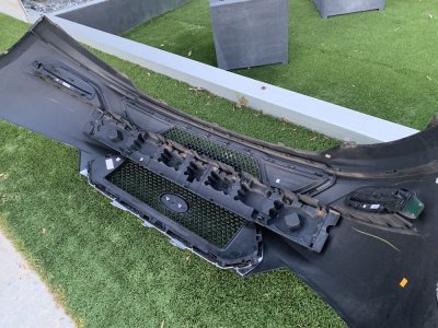

Moved the project to the living room. So, there's two large silver-plastic, grille-frame tabs holding the grille in place. Need to remove the spacer/cover-piece somehow.

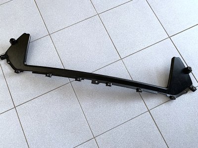

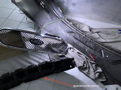

Finally figured it out!
I only had to depress four retaining-tabs on the spacer/cover-piece. Removing this revealed a ton of clips holding the grille-frame to the bumper cover [to remove: push tabs toward secondary-grille to release]. PI-grille snaps right into same tabs.

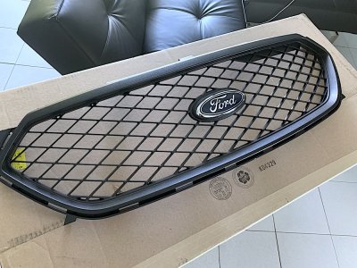

Voilà!
I only had to remove the spacer-assembly—just four simple clips which I hadn't noticed until after I got some rest. I think the larger grille-pattern makes for a more aggressive look, making the car less look like an over-sized Fusion.

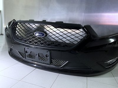

Finally!
Bumper-cover back on the vehicle . . . now, the SHO looks a bit less pedestrian. I also like how you can see through the grille and the car's guts are showing. Intercooler hoses look cool!
luigisho: Yeah! The PI-grille's built-in chrome-delete was a nice bonus!
Aha! One more snafu! The factory screws (for the top only) are smaller-thread than the PI-grille's tap. Gotta source some replacements.

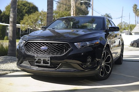

SHO Police Interceptor grille:
PID5
PID4

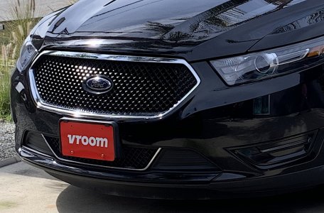

SHO factory-grille:
Oldgrille2

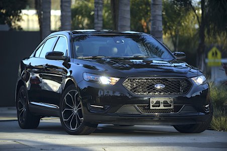

SHO faux-Police Interceptor:
The requisite beauty shot: Here's the car in my driveway after a quick hand-wash with a bucket of Dawn. Shot at ~180mm (full-frame) at maximum-aperture (f/2.8) at that sexy low-angle. Lens-height is about 20" off the ground, shooting from across the street ( ~70'). I had the 70-200mm's lens-collar mounted onto a carbon-fiber monopod which both stabilizes the shot and holds your framing.
The sun was low in the sky (approximately 5:30PM PST), the best time to take daylight-exteriors (high-noon is the worst time). Partially shaded, the sun's rays are directly hitting the grille at a low-angle, illuminating the radiator. I posted another PI-grille photo in my "SHO photos" thread, but you can barely make it out due to the diffuse, indirect-lighting.
I wasn't able put the Crown Vic PI-grille on my Marauder (facias are slightly different) but I did enjoy its cop car vibe. But no steelies or spot-lights for the SHO. I did see an all-black Charger with steelies and press plates recently, and I have to admit, it looked pretty cool.
