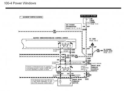

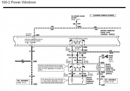

I'll look in my 92 EVTM tonight and see if I can get you any help. Should be the same as 95, I would imagine...
