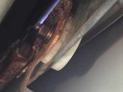

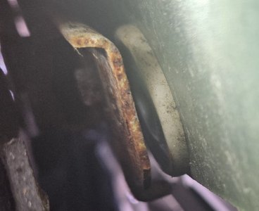

It's definitely off. Rivet sheared. I can get the replacements on Rock Auto but not sure how to get the tool in there to get the rivet installed.

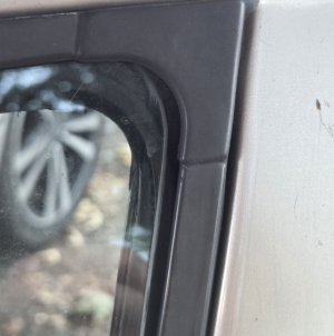

This happened on my current job. You have two choices. Replace the rivets:
What is much stronger, as recommended in the '94 shop manual:
1/4"-20 x 1" bolts, nuts, lock washers, steel washers (2) $12 Home Depot
Yes, 1/4" x 1". 1/4" x 3/4" may work, I can never remember til I'm in that situation.
Rivets are used during factory assembly because it's faster and simpler than bolting.

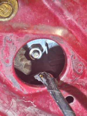

So far so good. Wish the Gen 1 had such a clear access to that.
712
Was a little concerned with how hard to torque it. Got it tight and will just check it later

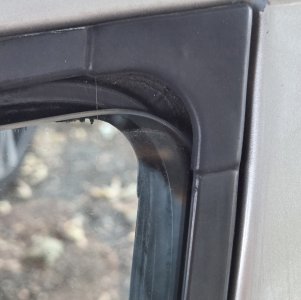

Is there a trick to where in the run the bolt should be tightened? I've been running into some alignment issues.
