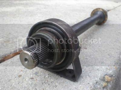

Anyone know where to get a circlip or the Ford part number for half shaft replacement? Doesn't look like my replacement shaft came with one.

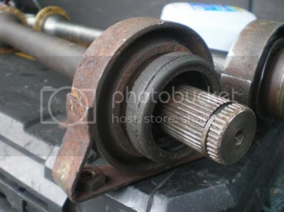

Your talking about the one that mounts to the engine right? I remember losing mine. I just used another axles circlip and it worked fine since the factory one was a pain to remove the axle, the rounded edge one was a bit easier.

The replacement shaft should have came with a new clip.
You have 2 options. Exchange the new shaft, or remove and use the old clip.
