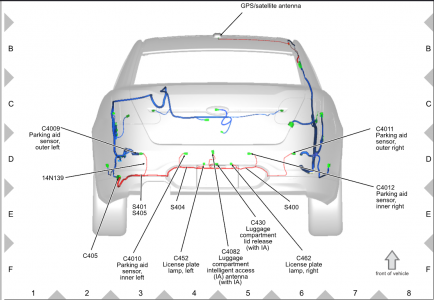

If you look at this picture you'll see that your problem shares a connector. Both the trunk switch and the park aid sensors go thru C405. Check that connector for loose connection or corrosion.
Also, have you used a high end scanner or FORScan to check all the modules for codes?

All other means to open the trunk function normally. I don't have a high end scan tool to see those codes. I checked the connector in the bumper and it was clean. It was my thought too since it is the point where both systems meet
