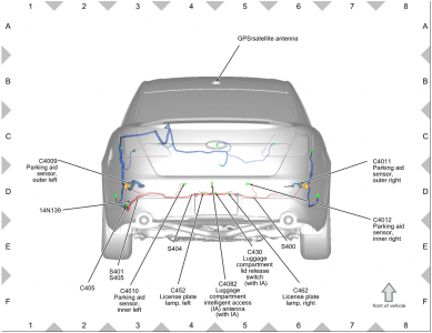

When i was trying to fix this problem I unhooked the wiring connector that's on the rear drivers side right above the muffler and I couldn't get it connected back up. Turns out the little rubber seal in there ripped and I had to get a pick and it came out on a bunch of pieces. Do any of you know where a can get a new seal at?

Are there any online versions of wiring diagrams that people have uploaded?

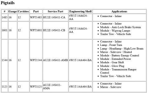

Awesome thank you! I'm going to try and see if I'm able to buy just the seal itself. It seems like the seal would be in the female side, which thankfully is the cheaper one
Seriously doubt the seal is available separately. Best chance for that is a u-pull-it.
Whenever you fix it, put a thin coat of dielectric grease on the seal. Don't put it anywhere else.

Thank you guys for the help. I was able to source a connector, take it apart, take the seal out and do the same thing with the connector on the car.
