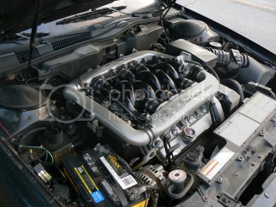

CIMG3340
A few years ago I did this one. The clear yellows over time, look at the intake compared to the non cleared valve covers.

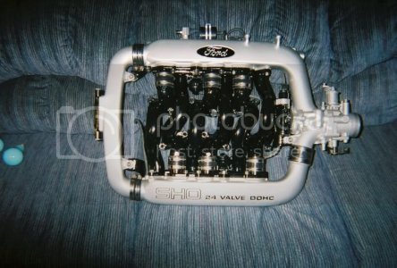

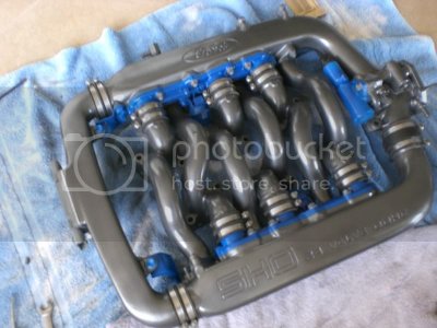

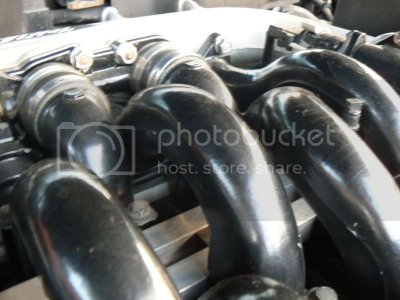

Yea, I'd say PC is really the way with solid "shiny" colors. My black was great when it was done, but after a year of heat cycles, its starting to dull a bit. I put at least 6 coats of paint on them, baked them, yadda yadda yadda.. The engine enamel just won't stay super shiny, and even has a crack or two.. maybe I did something wrong, I dont know. Took em down to bare metal even... The aluminum color held up well tho.
Before...
250901 R1 18 19A 1
After 13,000+ Miles and 14 months of driving...
P1050617
Still looks ok from this angle, but if you get a closer look, it has started to look hazy. And yes, I just wiped them down before the pic.. its not dust..
P1050618
