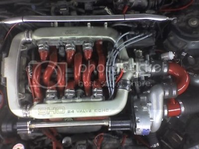

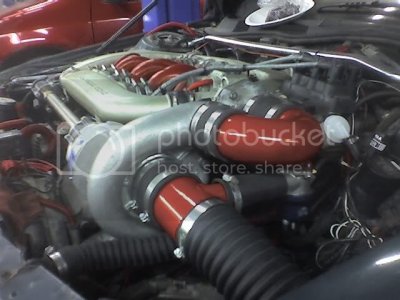

Also who bent all the piping for the setup? Im going turbo on mine but I dont know where to get the pipes bent just right. Do you think eventually you could help me fab a good setup on mine?? Obviously $$$ would be involved.
The pipes in the pic are simply a straight section of 3" pipe and a 90 degree mandrel bend 3" pipe (that is a pretty big IC pipe for that turbo BTW). And if you are looking for hot pipes, look no further than the GB section, where you can find your y-pipe and uppipe for a VERY GOOD PRICE. The IC pipes you can find all day on the net, as many companies offer polished alum mandrel bends in any size you would need.
He doesn't he has to be off of it for a while unless he wants surgery again and has to get studs in his ankle. I got the piping from ebay. I have several more pieces since it was a kit. Believe it or not it came all the way from Hong Kong.
I went with the seller because he had paypal most importantly. But the piping is longer (about 24-27 inches per piece) and thicker then the more common ones you see on ebay all the time (around 18inches per piece).

Its 2.5 inch tubing. Same as the outlet for the turbo.
That kit i got from ebay was around 130-160 shipped. came with the silicone hoses and regular clamps. I bought t-bolt clamps which i will be using for my setup.
