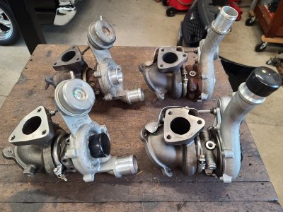

This is the best I have. The rear turbo is on the right. You'll be able to see the WG from the top of the engine with a mirror or go underneath and look straight up. The WG is at the back of the hot side of the turbo, just below the heat shield you see in the picture. Have you checked all of your hot pipe connections?

When I pulled my turbos, the rear one was missing the e-clip. How the arm had not fallen of the actuator, I do not know. No idea how long it had been.
