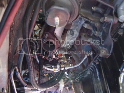

on a mtx its this
Oil sending unit is best to get from the bottom very easy to change. Put the car up on ramps of jack stands. Here is a pic of where it is minus the Tee and how easy it is to get from under.

Remember, if adding an aftermarket oil pressure gauge that you cannot use the oil pan drain plug to get an oil pressure reading. As seen in the above pic, you need to add a "T" fitting into the block to get an accurate reading for your new gauge and still have your stock pressure gauge plugged in.
