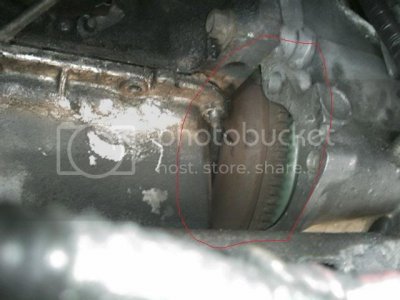

i removed 11 bolts and 3 nuts. The starter is off. not sure where the dust shield is located.

The dust shield is located between the block and the transmission. If you remove the two bolts that clamp the transmission to the block, you can pull it out. That hole you look through when you pull the starter out IS the dust shield.
It doesn't look like there is a dust shield on yours.
However, there are 4 nuts and 12 bolts, and 2 of the bolts go from the oilpan into the tranny.
