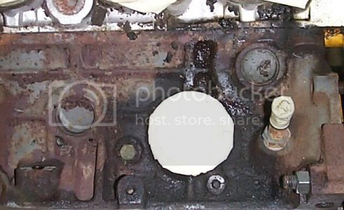

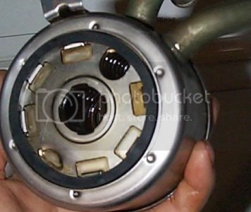

I know that I can buy the large o-ring that seals the cooler to the block from Josh and he even sourced an internal oil cooler o-ring for me. From the looks of the old cooler-to-block gasket, I'm not inclined to put in another of the same design. In the second pic, you can see how it just collapsed along the edges. Then again...it was in there a while.
This thing must have been leaking for a long time...
Oilcoolerleak
Oilcoolerwithgasket

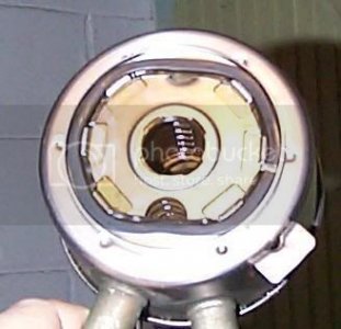

Oilcoolerwithnewseal
I doubt that I'm the first one to try the filter gasket in there...but if I am...I won't be the last...once people see how well it fits...:type:
I'm going to leave the cooler torqued onto the block for a bit and then inspect the gasket to see how well it sqwished.
I think the donor filter was for a 3.8 Windstar. It's an FL-820s Motorcraft oil filter.
