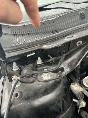

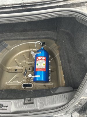

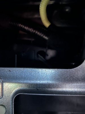

Some people have asked me how I ran the line from the trunk to the front so this is a quick break down. I went down the passenger side under the carpet and floor trimmings. Once up to floor board in front remove the glove box and located the cabin air filter box and drill through it and fed it through hole to exit vent under hood on passenger side. I’ll attach pictures later today. U will have to remove windshield wipers and plastic covers to access this but I found it much easier than a shot in the dark on drilling through fire wall.

Thank you not done yet. Still gonna make the trunk usable and put an access door there. And install my bottle blanket and push button lol it’s all for looks atm just give it some time. I’m going to Hawaii till the first but when I get back it’s right back to the grind.
