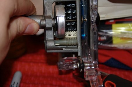

I'll upload a pic. I found out that I was missing a gear that connects the mechanical driven portion to the actual odo sprockets.
As for the speedometer being off, I'm sure that has to do with how I put it back together again the first time. What I did this time was held the magnetic driven dial in the back steady with a finger and rotated the needle down to the pin. Now the needle rests on the pin. Is that a good way of "calibrating" it? (Engineers, don't slap me!)

Odo gear
The white horizontal screw-type gear was what I lost. The crappy part is I think I threw it away at some point not knowing that it went to anything. Thankfully a JY had the whole cluster for $6.50.
