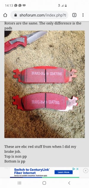

Sorry to be that guy, but I am about to pull the trigger on Tasca for a set of PP pads, but need to confirm these for a non PP car.
Again sorry, I have been searching forrhe answer, but my old ass can not find the answer.

I highly doubt it as the pp has dual piston calipers and the non pp has single pisons
Wrong, both are dual piston.
Here's a link. I wouldnt listen to Ryan. Aka @SHO_Off420.
https://shoforum.com/index.php?threads/pp-sho-brake-pads-vs-non-pp-sho-brake-pads.130721/
I wouldnt spend money off what he says without proof. Im pretty sure my non-pp has dual pistons for the stock calipers. I could be wrong though.
Thank you. This is the thread I was looking for...
Fronts are two piston. Rears are single piston.
This is across all model years from 2010, to 2019. No matter PP equipped, or not.
Changes that occurred in 2013 were to switch to larger rotors, with vented hats. Silicone boots too.
The PP equipped cars have slightly larger pads with greater contact surface.
