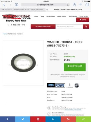

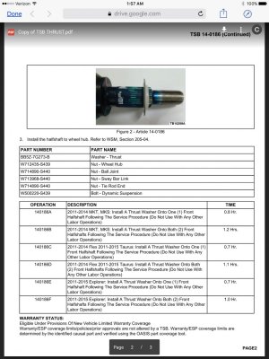

I just found this. It's not the thrust washer that goes bad. The TSB says to install a thrust washer.
I’ve installed both washers, it’s really only if you get the pop /ting when going into drive/reverse after parked. The older version is metal the new one is plastic.
They are the same part number so you don’t know which your getting.
I’d did not fix the low speed clunk.
I’m with doit221 thinking it’s the lower control arm,ball joint , bushings.
