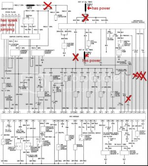

here is a diagram of what all wires we have jumped power into.
this turns the fuel pump/fan/ignition system on, but no fuel injectors...
car will start if you spray bottle fuel into the intake while you crank it, then continue to spray fast once it fires up... when it does run, it runs at like 11.8 volts, so the alt. is involved somehow???!?!?!
