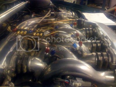

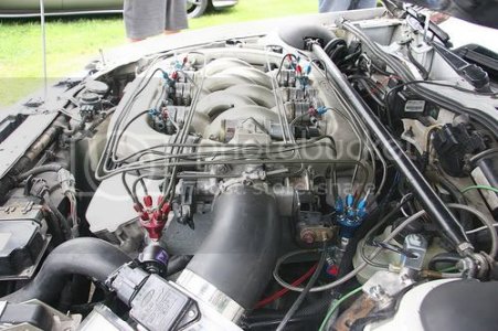

Nitrous and cams go great together.
I did a 3.2L high compression engine with about 130hp Pro-Fogger system. It put 340hp to the tires. What a blast.

holy shyte! wow thats awesome brian! i only dyno'd 265 back in october with 400 psi bottle pressure. i really needed a heater.
