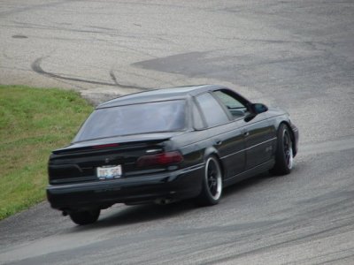

Only thing I don't like about niteshades... application error can cause them to be uneven.
This belongs to someone on the forum. :theyareontome: Althought they may have been fixed since.
Dsc09542
thats steve "sinistersho" i dont remember them looking like that tho.

sometimes mine look the same way. when the sun hits it at the right angle the sun light will reflect of the tail light.. making it light up just enough to make it appear to be uneven.

:rofl: Yes, that is my car, but they were not my tail lights. A buddy (who is also a member) and I swapped them on right before we drove to the 07 Convention. I noticed once we got there that they did not really match.
