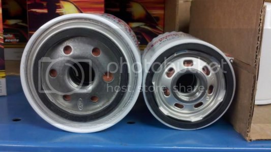

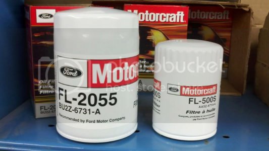

UPDATE I ordered the filter in today. The filter is huge. Im not sure this is going to fit without clearance problems. I will update when I try to install it.

Yikes -- that's the FL-1A size and makes the 500S look like a toy.
Hope it fits without clearance issues. I'd much rather use that one than the little one.

Holy Cow! is there room under there for this? I haven't changed my oil myself on this car as of yet.

Wow, I hope it fits without problems...the extra oil capacity is also a plus. I like the idea of 6.5 quarts of oil in the engine.
