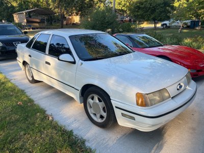

Hello, couple months ago I found myself a 1991 SHO. It’s currently leaking oil from the rear main seal and oil level sensor (ironic I know) but parts are on the way to fix it. It also has a low coolant light do to a failed coolant level sensor and unfortunately still hunting that part. Other than that it has run great and is a joy to drive! Joined in hopes of getting help and advice as time goes on when I need it.
