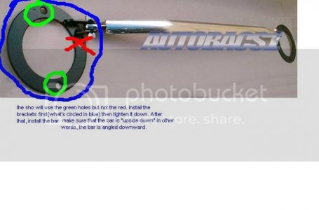

I HAVE this front neon STB for 95-99 neons.. and it's supposed to go in the rear of gen1/2 SHOs.. but.. I'm looking at the thing and I can't figure out how to get it in? I thought it just bolts right in? Can anyone give me some help? What's the trick? do I have to redrill?

the bar has to be turned upside down. Use the picture below to help with putting the brackets on. Once you have both the brackets on, with the bar connected to one bracket, adjust BOTH sides of the bar to the length it needs to be and put it in place, the brackets will need to bend a slight amount but putting the bar up will take care of it for you. Once you have both ends of the bar into the bracket, and both bolts are holding it, tighten them down as tight as you can get it, with the allen wrench. In the directions under the picture, I said tighten down the brackets first, ignore that. Tighten down the brackets after you have gotten the bar in place, with the bolts holding it. Then tighten down the bar end bolts. If I had a picture of mine in the car, I'd show you but this is the best I can get. There is no need to redrill the holes if you install it the way that I described.

Just for the record though if a gen1 owner wants to do this it works but you have to cut half of the ring on the end off for it to clear because gen1's have a **** type bulge back there on the strut towers. I just cut close to the holes you use to mount it and that made it look like C's on the sides. Worked beautifully.

I'm about to do this myself... just to be clear do you think you could quickly show this in a MS Painted photo of the bar?

anyway, back to that photo posted above, do you use only the two inner bolts, and not the rear/outside one? and have the one marked with the red "x" sitting free between the strut towers?? or....? does anyone have any pics of it posted on their rear strut towers?

Hey man im sooo sorry i never saw your post. Sorry it took so long to catch your question. I took the same pic above and airbrushed in pink what you cut off. If you need to ask me anything let me know. Ill be sure to check this thread again. This is what i had to do to get it to fit in my 89, however this alteration wasnt required on my 93.

awesome, thanks for the reply. what'd you use to cut it off?
A little hand held grinder with a cut off blade from the local hardware store. Im sure a jigsaw with a metal cutting blade or a hack saw if youve got enough patience would be sufficient. It took all of about a minute to cut it with the cut off wheel.
