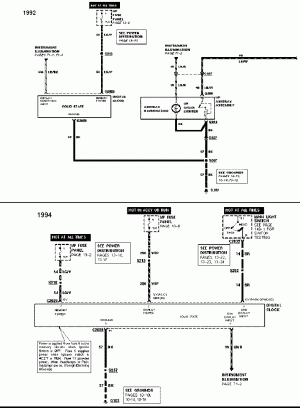

Hello, i am looking for a wiring diagram for the 5 wire clock. I want to get the clock in my 92 working, but i have a newer gauge bezel that has the 5 wire in it. I did a search but found the file was too big to post and it was email'd to everyone who needed it.

Needed wiring diagram for a 92 to black 93 interior swap ;)
It didn't come up initially, but I found a link to the pic that would work and posted it for anyone else that might want it.

Going from a 5 wire to a 3 wire clock is easier than going from a 3 to 5 wire clock - I know jelloslug did it, I guess he just added the wiring that he needed.
