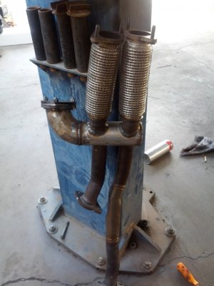

I do live in Phoenix, I have the factory cats and the rest of the downpipes BUT mine have been modified to install my cutout. I'll happily lend you my cats or sell them to you but you'll need to get the other parts from the dealer or somewhere else.
IMG 20121011 154744
You'll need to buy 5G203A and 5G203B from this diagram:
http://www.lakelandfordparts.com/sh...ukey_driveline=0&ukey_trimlevel=0&modelyear=0
I don't know any one else that is local btw with downpipes done.
Maybe Shomeda$ can send you those two pipes and then he doesn't have to ship that cats.

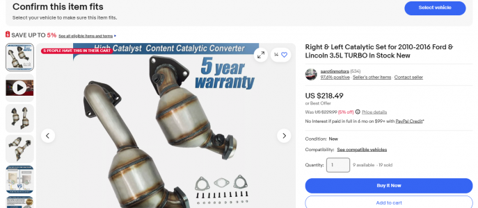

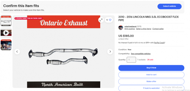

right now on eBay you can by the cats and then they call it a "Flex" or "intermediate pipe". These two items together designed for you application's fitment = your downpipes. Some of those cats looks better flowing that out, and the intermediate pipe looks solid. Not to mention ...it's probably 500$ for everything with shipping

and the cats -> there are SO many damn variations of thes on ebay... i mean, and theyre cheap.

This is so you can use one larger cutout unit to control the valve to dump the exhaust right before the flex pipes feed into the 2 bolt flanges? That's pretty damn clever
