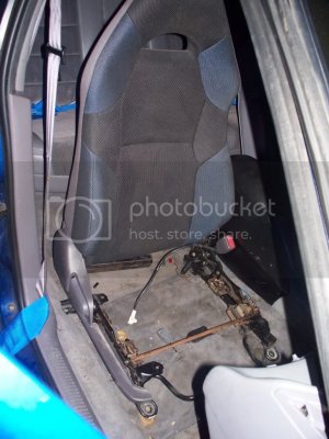

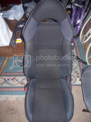

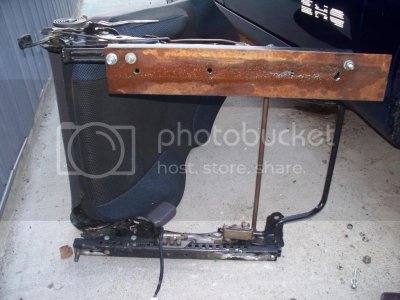

I had these for a year now and finally have a minute to put them in.

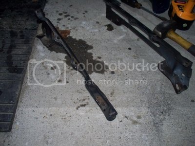

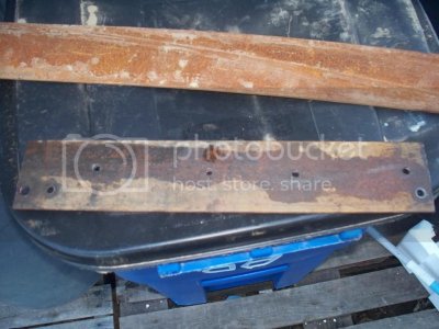

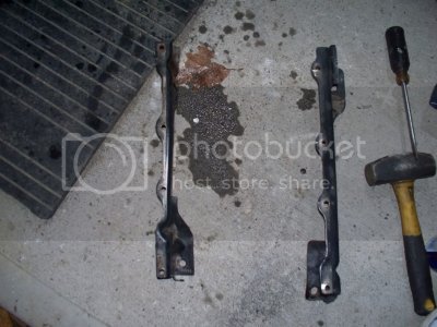

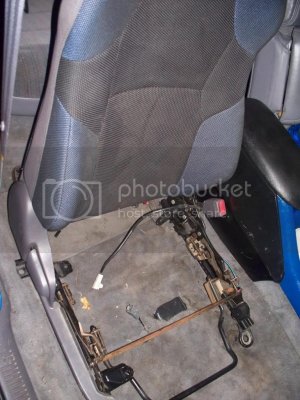

These came off Toyota Celica, very simple but very very comfortable. Last summer I rebuilt bottom part of my stock SHO seat and that took me a week, came out good, but stock seats weight a ton and motors brake as usuall. Anyway, motors finally gave up on both of my seats and I want manual lighter seats. I was going to weld one bracket to another, but still had to modify original brackets. So I thought about modifying the whole thing and try to bolt it on. brackets are pretty much done, the only thing I have to do is to bolt on driver's side brackets together and put cushions back on. OH, and seat belts work with Toyota clips(or whatever you call it).

I put passenger seat in today and it sits good in it. The only thing it is not that much lower comparing to stock seat lowered. That doesn't really matter, because seating position is much more comfortable. I am going to try and use smaller brackets from stock Power seat to make driver's seat lower, because I like sitting on the floor.
