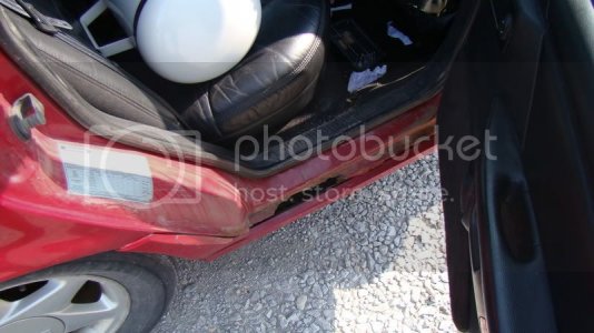

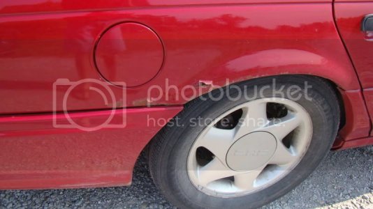

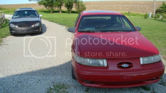

1993 Red/Black MTX, 165k, its over heating like a son beach, though. Fan is working so I dunno what the **** the problem is right now. It's at Joe's house of SHO repair and blues, so it's all good :)
Work is about to begin!

Ewww

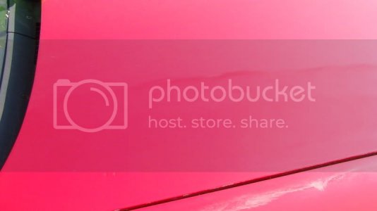

After a quick wax to see what the paint looks underneath the haze

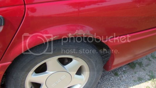

DSC01561
I don't think that is "normal"

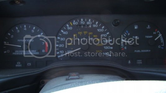

I should be out tomorrow, depending on if my parents are in town. I'm going to try to find an IR temp sensor to see what the coolant temp is at. Otherwise, I'll jerry rig a $10 mechanical sensor to find out the temp. Apparently it still is "normal" but reading like an ass hat on the gauge.
zblackbeast
SHOtarded
Feb 9, 2008
2,632
374
Omaha, NE
Yea, before i even got the sho running tonight my sensor is at 12 o'clock... i wonder why????

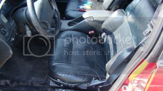

The intake is partially cleaned, the cam covers are cleaned, the seats have been leather conditioned, and we're about ready to drop the factory Y pipe and oil pan. Come on RCM!
