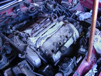

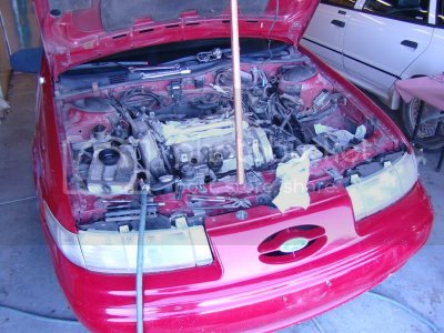

DSC01674
DSC01673
The back three plug wells were soaked.

I'll spray some more PB on them before I go to work, hopefully they will come off. If not, there are several ways around it.

Ugh, so an incredibly busy month later and I'm about a day away from finishing the car.
It has a had new:
Rod Bearings
Water Pump
Plug Wires
Plugs
Belts
Intake Gaskets
Cleaned LIM and Intake Runners & Surge Tanks
All in all, this project went way over in the time department and HAS to get moving on it's own power this weekend. So I'm burning the midnight oil again and finishing her up.
To Joe and his dad :hail: I owe you guys steaks when we grille out, I'll bring them!
